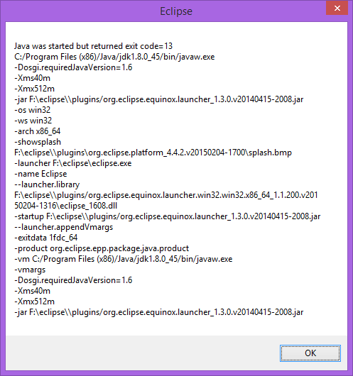

On 04/24/2015 08:42 AM, Somen Singh wrote:
> Hi All,
> I went through the post here but still could not find myself comfortable.
> I installed an eclipse i.e eclipse-java-luna-SR2-win32-x86_64
> Java versions:
> I have multiple versions installed.
> 1. jdk1.8.0_45
> 2. jre1.8.0_40
> 3. jre1.8.0_45
> I tried adding the -vm into eclipse.ini file but still no help.
> My eclipse.ini file looks like this:
> -startup
> plugins/org.eclipse.equinox.launcher_1.3.0.v20140415-2008.jar
> --launcher.library
> plugins/org.eclipse.equinox.launcher.win32.win32.x86_64_1.1.200.v20150204-1316
> -product
> org.eclipse.epp.package.java.product
> --launcher.defaultAction
> openFile
> --launcher.XXMaxPermSize
> 256M
> -showsplash
> org.eclipse.platform
> 256m
> openFile
> --launcher.appendVmargs
> -vm
> C:/Program Files (x86)/Java/jdk1.8.0_45/bin/javaw.exe
> -vmargs
> -Dosgi.requiredJavaVersion=1.6
> -Xms40m
> -Xmx512m
> Error message that I am getting is:
> Java is installed is installed in following part:
> C:\Program Files (x86)\Java
> Eclipse is in F:\ {drive}
> Please help me guys. I am noob here.
> I am trying to learn Selenium automation testing. This is my requiremet.
Why would you try to run a 64-bit Eclipse using a 32-bit JRE?
