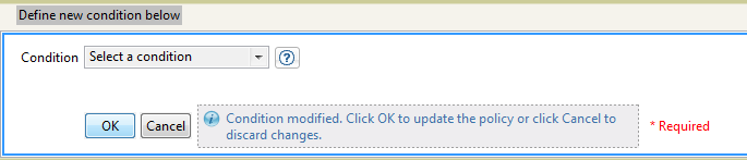

In my Eclipse based application I have a dropdown which RCPTT is not able to recognise.
Class name of the dropdown is - "com.novell.core.ui.widgets.KeyListenerCCombo"
Is there any way, I can make RCPTT recognise this dropdown ?
I have also shared a screenshot for your better understanding of the problem. Please do let me know if you need more details on tis

Re: RCPTT is unable to recognise a dropdown [message #1692692 is a reply to message #1692664] Fri, 17 April 2015 07:20 Go to previous messageGo to next message
Is "com.novell.core.ui.widgets.KeyListenerCCombo" an official an official eclipse project? Or is it renamed to this name by the developer? Kindly check on that.

Re: RCPTT is unable to recognise a dropdown [message #1692829 is a reply to message #1692664] Mon, 20 April 2015 01:07 Go to previous message
Do you have any errors while recording or replaying?
Please save failed test, execute it, click "Details..." in Execution view and send us content of the appeared dialog.
Attach ECL-code which is generated by recording actions on this dropdown.
Please attach Widget details (how to get it).
Could you please share your AUT for our local reproducing?
You can send it to me directly by e-mail (olga.yurchuk@xored.com).
