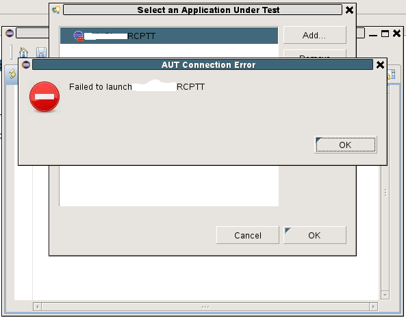

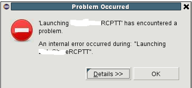

I have attached the screen shot (Method1.PNG)

Is this method right? However there is another option in Applications tab in RCPTT perspective. There I can add a new application by right click New and select the application. Whenever I try to select the application, it says "Invalid product location". I am selecting the location of the .product file. I tried to choose other locations like .target, etc as well. The message "invalid product location" did not go. Do I have to try this method as well? I think it need to provide me something same as the above method with I have mentioned.
Please find two images attached.

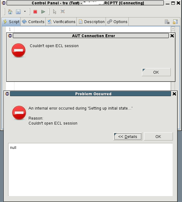

Now the error with your new plugin link is different. I have attached the screen shot of it here. (Attachment: Err.png)
There is an error log generated in Error Log view:
Error Log: Event Details
Error Stack Trace:

I have also uploaded the files you have asked for.

Steps Which I followed:
Brought up Eclipse Mars and imported by project there.
Launched my project as an application.
Saved my Run Configuration which I used to launch my project as a .launch file (Lets say ABC.launch).
Installed RCPTT with the link which you just gave.
Went to Run Configuration > Eclipse Application Under Test > New (Lets say name as: XYZ)
In the target, gave the previous .launch configuration with I just created (ABC.launch).
Went to RCPTT prespective and created a new RCPTT Project and a new Test case
Clicked on Record and selected the XYZ from "Select an AUT" window.
The application started and crashed.
I also tried by plainly running XYZ from Run Configuration, which also did not work.
Please let me know, how to solve this.
