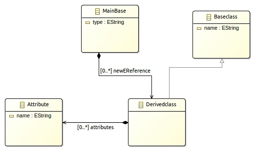

This sounds like a pretty standard arrangement. I'd expect you'd be
able to generate all the projects, and that the MANIFEST.MFs would have
dependencies where needed to resolve the imports. Do the unresolved
imports exist and just the dependency is missing?

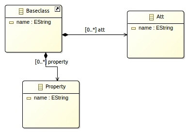

> I have two metamodels Amodel and Bmodel as shown in figure
> Bmodel extends a class(Baseclass) in Amodel
> My end result should be:
> 1) I should be able to create a model.Amodel with instances of all classes in Amodel and Bmodel metamodel.
> 2) I should be able to create a model.Bmodel with only instances in Bmodel metamodel.
