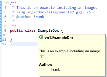

I created an example.
When i hoover over the Symbol "ExampleDoc" as a source, i get this tooltip:
index.php/fa/21510/0/
When i put all relevant into a jar, i can use it, and it can get the JavaDoc text, but not the image:
index.php/fa/21511/0/
See the attached JavaDocExample.jar
Still the question:
"Problem between keyboard and chair" or a bug?
thx
Frank
