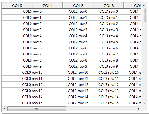

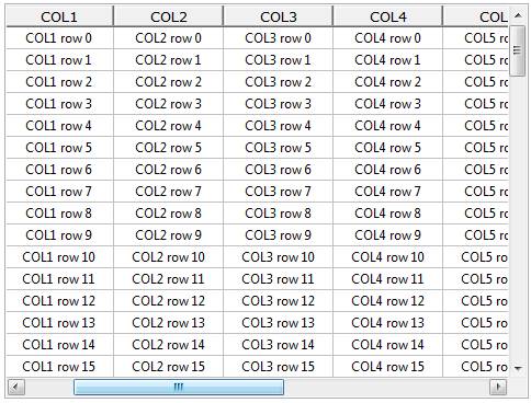

I prepared simplistic example showing what the problem is. Forget about my previous code with multiple rows per item etc. The "disappearing column" behavior can be observed on very basic implementation.
In the attachement I uploaded class that builds up a nat table - to place it on parent container, call SimpleNatTableExample.buildinstance(parent).
In the example, I create simple grid with header. The grid has 10 columns and 100 rows. Column 1 has column span of 2. When I run the example, if grid is not scrolled (screenshot scr01.png), everything looks like expected: column 0 has span of 2 and has value of "COL0 ...", header has COL0 and COL1. Now I scroll to the right.... and just when in header COL0 is out of sight the grid shows what is on screenshot scr02.png. This is not expected behavior of column span functionality.
The expected behavior is presented on mockup expected.png.
The expected behavior is that when column 0 has column span of 2, it is visible when header column 0 or column 1 are visible. So when header column 0 disappears from sight, column 0 still needs to be rendered as in reality - it is in sight because it has span of two.
I do not know how to explain it clearer. I think this behavior is a bug. What is your opinion?
