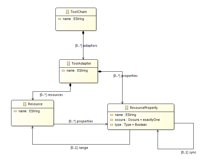

I'm learning Sirius. This is a simple model.
see attachment 1.png index.php/fa/21353/0/

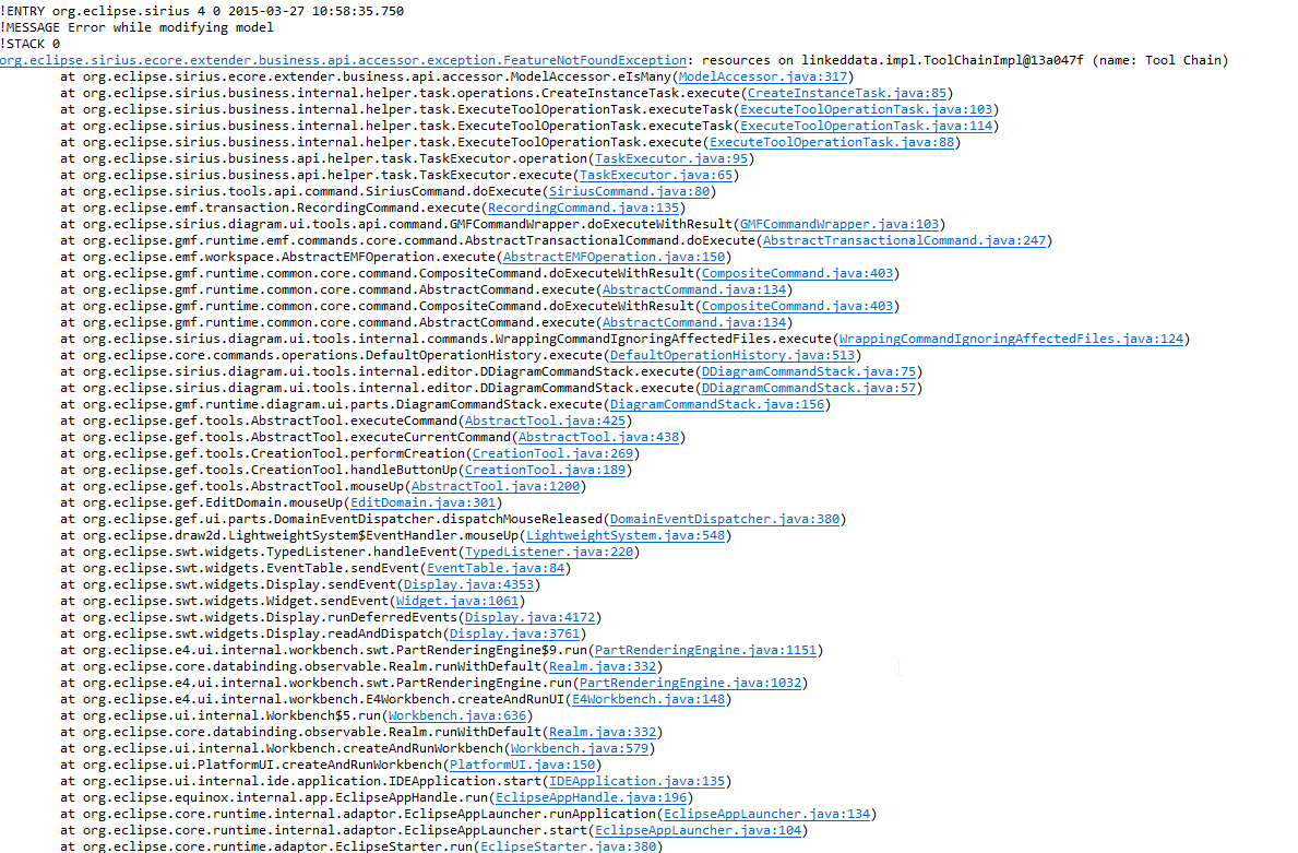

I use the same way to create the other tool for "resource". Then it doesn't work. and the FeatureNotFound exceptions pop up.
see attachment 3.png index.php/fa/21355/0/

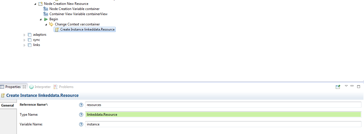

The "resources" reference is not feature for "ToolChain", but it is a reference for "adaptors". I set change context for this operation with "var:container". Here is detailed info for the create instance operation.
see attachment 4.png index.php/fa/21356/0/

My first guess is that you created your first node creation tool for
ToolAdapter. It worked. Then you copied it to create the node creation
tool for Resource but did not update the field "Node Mapping" to the
Resource node mapping instead of the ToolAdapter node mapping. Can you
check it on the general tab of your tool?

Hello, Steve,
I have solved the problem. The root cause is that I don't set the context correctly. I want to create resource node on the diagram, but in my metamodel, the resource belongs to adapter not the tool chain.
