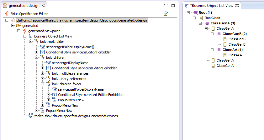

I have tested your example and it works perfectly. In fact, the tree representation I am trying to create is a little more complex. Our semantic model can contain a lot of objects and references, so we would like to show in our tree representation the contents of every one-to-many reference as a folder whose label displays the number of referenced objets. Then, once the folder is unfolded, the end user can access the referenced objects themselves.
index.php/fa/22239/0/
To be able to achieve that, I created an EMF type called Folder encapsulating the source object and the reference's feature id. I created 2 Java Services used as "Semantic Candidates Expressions" in my VSM.
- List<Folder> getFolders(EObject) : creates then returns one folder per reference whose source is the EObject parameter. After being created, the Folder objects are attached to the Sirius session using the SessionTransientAttachment eAdapter.
- List<EObject> getFolderContents(Folder) : returns the list of the referenced EObject associated to a Folder
It works perfectly when accessing the model in a read-only way. But when I try to change the contents of the model from my application (either from a Create Instance action, or using another view or doing it programmatically), my tree representation collapses immediately.
I also noticed that the collapse/expand status of the tree items is serialized when I save the representation (expanded="true"), but when I load it again, the whole tree is collapsed.
I guess that it has something to do with the use of transient Folder objects. Is there a smarter way to achieve my goal using more standard mechanisms in a way that the tree's expand/collapse status is not lost at each modification ?
Thanks in advance,
François
