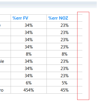

Another problem is that sometimes the end of the table is not correctly rendered:
index.php/fa/21128/0/
We think that the two problems are connected, but we are not sure about it.

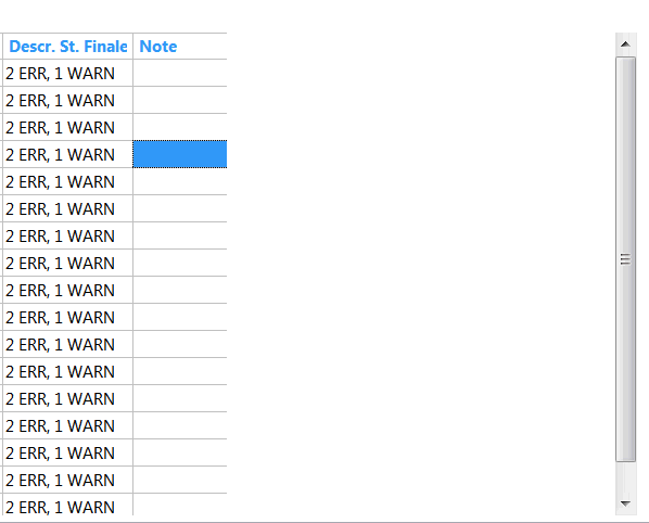

the ContestualMenuPainter extends the Nattable's ImagePainter and draws a "menu icon" in the first column of the Nattable (as shown in the screenshot). I attached the source file, so You can have a look at it.
index.php/fa/21145/0/
Anyway, the problem appears also after removing the Painter even if it is a little bit different (there is a HashMap.containsKey() instead of a HashMap.get()):

The only issue we are still experiencing is that sometimes the "right end" of the table is not correctly rendered (I wrote something about it in the first post):
index.php/fa/21241/0/
We thought that this issue was related with the StackOverflowError issue, but it seems to be a different kind of issue.
It seems to appear only when the Nattable is initially rendered and when all columns are visible. If, initially, the Nattable is partially rendered and we use the horizontal scrollbar to go to the last column, the issue does not appear.
We don't experience the issue for the "bottom" of the table.

Yes, it's related to scaling (I forgot to write it in the previous post). The table is correctly rendered when no scaling is applied.
For example, in this table:
index.php/fa/21243/0/
we have 6 columns and we have a default column width for the columns B (70px) and E (70px).
Also in this case, if we remove the bodyDataLayer.setDefaultColumnWidthByPosition(), the table is initially correctly rendered.
Maybe this could help you: we use the NatTableBorderOverlayPainter() as table overlay painter.
