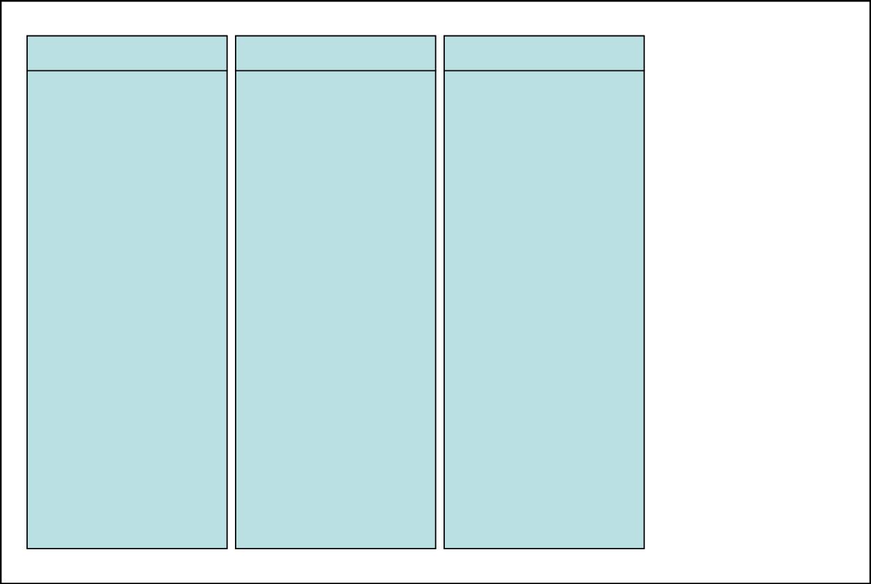

I am trying to implement swimlanes using GMF. I want to achieve something
that i put in the attachment.
Can someone help me how I can do this, I mean how and where to set the
custom layout.
regards,
Phani Kumar K.
  • Attachment: layout.jpg
    (Size: 38.56KB, Downloaded 120 times)
Re: Diagram Editor Layout [message #60436 is a reply to message #31806] Fri, 06 October 2006 17:28 Go to previous messageGo to next message
Originally posted by: fbfd.NOSPAMarcor.de
Have you been successful implementing this in the meantime?
I also need swimlane-style-layout.
Any hints welcome.

You have to implement the layout on your own (which is not that
difficult). As there is currently AFAIK no possibility to add a layout
to the canvas you might want to have a look to the
presentationLayoutProvider extension point in
org.eclipse.gmf.runtime.diagram.ui.layoutProviders.
Kind regards
Bernd

Once more me :-)
Maybe it is sufficient to use the
org.eclipse.gmf.runtime.diagram.ui.providers.LeftRightProvid er and set
layouthints for your swimlane figures
Bernd
