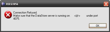

On eclipse now I try to connect to this Daemon on 4075
Daemon failed to launch server on <IP> using port 4075
Connection Refused.

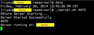

Here is the steps I did to manually connect to the server
[riyaz@TEST123 rseserver]$ ./server.sh 4075
DStore Server Starting...
Server Started Successfully
4075
Server running on: TEST123
Connection error
Server: error initializing socket: java.net.SocketTimeoutException: Accept timed out

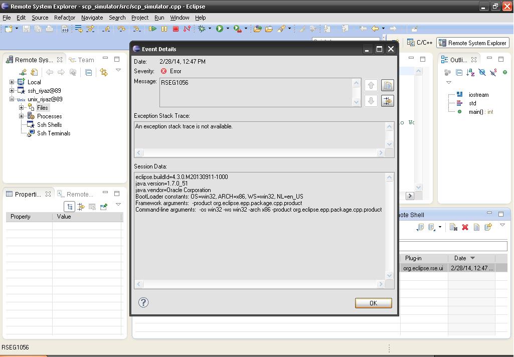

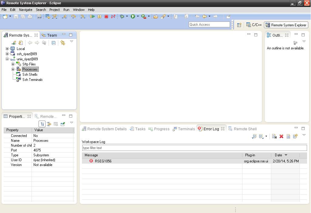

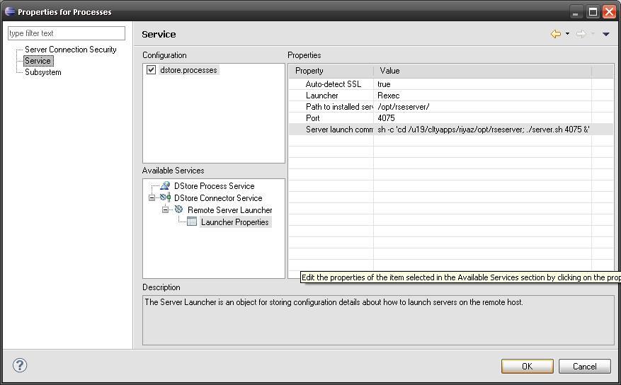

Below are some screen shots that might help
index.php/fa/17529/0/
index.php/fa/17535/0/
index.php/fa/17536/0/
index.php/fa/17537/0/
NOTE: FILES, SHELL AND TERMINAL GETS CONNECTED USING SSH SO I DON'T THERE THINK SO THERE IS A PROBLEM IN CONNECTIVITY.

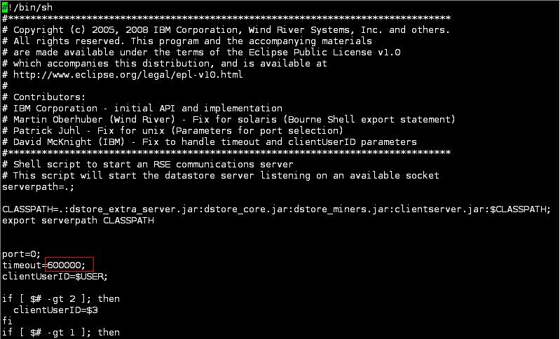

Yes I started the server and tried to connect to it from eclipse after 5 to 10 seconds eclipse says Connection Refused.
I even tried increasing the timeout value to 10 mins just added a zero to the timeout value. But still eclipse says Connection Refused.
Note that the daemon runs on port 4075 by default but servers that get launched run on different ports. By allowing only port 4075 through a firewall will still leave the server ports blocked. If you're trying to run a server on this same port at the same time, you should run into a bind problem on startup. That said, I don't see any message indicating a bind failure with your manually run server test so I assume you're not running both at the same time in this instance. Could you request that a second port (in addition to 4075) be opened? If you do that, then you can specify the second port as the subsystem port.
Yes I know if daemon is running on 4075 so the server will run on some other port I understood this when port was already opened.
Now that 4075 port is open I want to try manual server connection on this port before opening other ports.
I did netstat to see if 4075 is being used by server and it says 4075 is in LISTEN mode before the server timeouts.
I found this from the help docs
If your daemon runs behind a firewall, you may want to specify the optional serverPortRange argument to restrict selected server ports to the range given:
perl ./daemon.pl 4075 10000-10010
Server requires more than one port for connection? Do I need to open each and every port from 10000 to 10010?

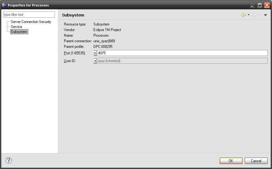

index.php/fa/17600/0/
index.php/fa/17601/0/
index.php/fa/17602/0/
[Updated on: Fri, 28 February 2014 02:29] by Moderator

3) The default socket io timeout value may be too small (if this is a slow connection). That can be configured under Preferences->Remote Systems->DataStore.
I have tried that also...
Re: RSE Daemon not working [message #1274563 is a reply to message #1274459] Fri, 21 March 2014 12:43 Go to previous messageGo to next message
Riyaz Parve wrote on Fri, 21 March 2014 09:53
1) Your user id not having read/execute access to the auth.pl script in the server directory.
I use root to run the daemon and I use my user in eclipse to connect to the daemon, so only user with root permission can use daemon ?
Only root can run the daemon since the auth.pl script that authenticates the user will only work with root permissions.
Re: RSE Daemon not working [message #1714053 is a reply to message #1245895] Mon, 09 November 2015 10:18 Go to previous message
For me, the problem was permissions on the parent directory where the RSE server utility was installed. In other words, as suggested above, the fact that the user that was logging in did not have read/execute permissions to auth.pl prevented it from logging in and executing the necessary utilities.
