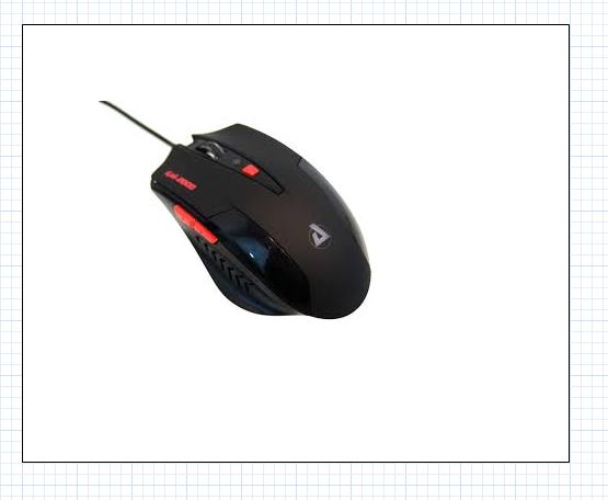

I add an Image to the PictogramElement and it works.
index.php/fa/14169/0/

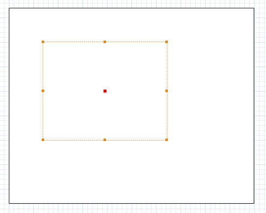

After I close and reopen it, the image is not displayed.
index.php/fa/14170/0/
Please give me idea for the strange behavior.
Note: I also try to remove the image when the editor is closed and add the image as the editor is opened to imitate the behavior when the image firstly created. But it also didn't work.

Re: Image is not displayed after reopen the plugin [message #1027697 is a reply to message #1027539] Wed, 27 March 2013 05:31 Go to previous messageGo to next message
Emerson,
what do you mean with close and reopen? The diagram or Eclipse?
The way you do the image registration only works as long as you plugin is
loaded, after e.g. restrating Eclipse that image won't be rgistered anymore.
In order to make that work you should define an ImageProvider for your
plugin and register the image there. You can then simply add the image as
you do it by referencing the contant from the image provider which will be
available automatically after loading the diagram.
There's a section on images inthe tutorial:
http://help.eclipse.org/juno/index.jsp?topic=%2Forg.eclipse.graphiti.doc%2Fresources%2Fdocu%2Fgfw%2Fimages.htm&cp=30_1_6
Michael
