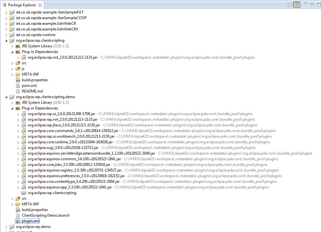

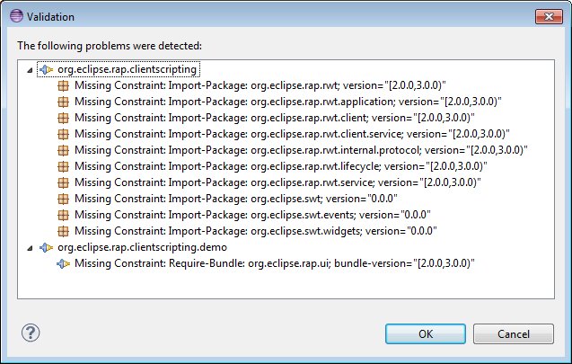

Re: RWT/RAP VerifyEvent support and ClientScripting [message #990894 is a reply to message #990826] Fri, 14 December 2012 12:12 Go to previous messageGo to next message
Hello again, if you are in the process of renaming and cleaning things up, does it mean that the nightly build (13th Dec) is potentially bust?
I've installed RAP 2.0 M3 nightly from 13th Dec and my own application no longer starts up under RAP (SWT and RWT still work ok). The rapdemo project still works ok under RAP though, but I'm struggling to see what I've done wrong.
After applying the nightly build I had to change my IEntryPoint Class to reference EntryPoint instead, which I presume was one of the recent changes you made? Otherwise, no changes, and no other errors reported.
Sypmtoms are that when I launch the RAP app from within Eclipse (4.2.1), OSGi starts ok, and the OSGi console reports that my bundle is ACTIVE. However, the browser starts up and I just get a 404, as if the Application was never registered. Looks like a problem with the Application Extension, but I cannot see what.

Ok, so ClientScripting setup next, which I'm struggling with, related to versions of bundles I think, although everything appears to be good. This is with ClientScripting from git on 14th Dec and RAP 2.0 M3 Nightly from 13th, so pretty much in sync.
I've imported 2 projects from the ClientScripting Zip (clientscripting and clientscripting.demo), which appear to be the only ones actually required for this test with RAP. No project errors, but if I try to run the RAP demo for ClientScripting, it complains with the following unresolved dependencies:
index.php/fa/12727/0/
The Dependencies look ok to my eye:
index.php/fa/12728/0/
Can you help point me at the piece that is versioned incorrectly?
Thanks, John
Re: RWT/RAP VerifyEvent support and ClientScripting [message #991109 is a reply to message #991104] Mon, 17 December 2012 06:50 Go to previous message
Actually, it would have been interesting to get the demo working... but the good news is that I have integrated the UpperCase example logic into my own project, and it works perfectly, first time, so no specific need to get the demo working now!
