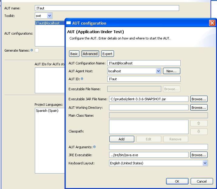

When i launch my aplication, first i launch a loading screen and then the main aplication, but i can only map the loading screen.
if i try to map my main aplication, i cant.

Re: cant target my aplication [message #849619 is a reply to message #849594] Thu, 19 April 2012 05:57 Go to previous messageGo to next message
index.php/fa/7985/0/Windows xp profesional, eclipse 1.2.0
swt aplication, using eclipse to develop it and maven to compile it.
No errors come, no log entries. i have no problems mapping loading screen, but i cant map nothing in the main screen.
connect to aut, then start aut, open my test suite with object mapping editor and try to map it, but i cant, no green square.
my aplication takes 2-3 minutes to launch. maybe this could be a problem...
  • Attachment: step1.JPG
    (Size: 66.21KB, Downloaded 671 times)
