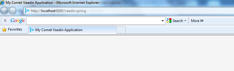

When I request the application I receive empty page (see attachment).
In the log files there are no errors, you can see what I have in the access log (see attachment)

Re: Problems registering two servlets in a WAB [message #758582 is a reply to message #758226] Wed, 23 November 2011 13:26 Go to previous messageGo to next message
Ok
I got the latest sources and built them.
I added again the three additional jar files mentioned in my previous post.
I removed the context.xml from the web application.
Here is what I can see in the browser - see attachment
Note: I forgot to mention in my previous post that WABHeaders=defaulted
Could you please verify that the response that I received is the one that you expect?
Violeta

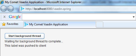

Re: Problems registering two servlets in a WAB [message #758727 is a reply to message #758582] Thu, 24 November 2011 07:19 Go to previous messageGo to next message
Hi Violeta,
yes, the result u have to see is the last message 'this label was pushed to client' after a few seconds. It is pushed by the server after a thread slept during a few seconds.
I check the same in my Virgo configuration but i still have the same error.
How did u do to amke the project works?
Re: Problems registering two servlets in a WAB [message #758792 is a reply to message #758727] Thu, 24 November 2011 10:04 Go to previous message
Here are my steps:
1. Unzip Virgo 3.0.1
2. Change WABHeaders=defaulted (Virgo-Home/repository/ext/org.eclipse.virgo.web.properties)
3. Build the both projects provided by you
4. Put in Virgo-Home/repository/usr:
4.1. vaadin-6.6.6.jar
4.2. com.thingtrack.com.vaadin.addons.osgi-0.0.1.SNAPSHOT.jar
5. Add in Virgo-Home/config/org.eclipse.virgo.kernel.userregion.properties
repository:bundle/com.vaadin to the initialArtifacts
6. Start Virgo
7. Modify the web application
7.1. Removed context.xml
7.2. Added atmosphere-compat-jbossweb-0.8.0-RC2.jar to WEB-INF/lib
7.3. Added atmosphere-compat-weblogic-0.8.0-RC2.jar to WEB-INF/lib
7.4. Added atmosphere-compat-jetty-0.8.0-RC2.jar to WEB-INF/lib
8. Put the application in pickup
9. Request it Wink
Please check in the console that the deployed bundle has in the Bundle-Classpath you have listed all jar files from WEB-INF/lib
Here is what I can see on my system
osgi> h 118
Bundle headers:
 Archiver-Version = Plexus Archiver
 Build-Jdk = 1.6.0_25
 Bundle-Classpath = WEB-INF/classes,WEB-INF/lib/serverpush-1.0.6.jar,WEB-INF/lib/atmosphere-gwt-client-0.8.0.RC2.jar,WEB-INF/lib/atmosphere-gwt-server
-0.8.0.RC2.jar,WEB-INF/lib/atmosphere-gwt-common-0.8.0.RC2.jar,WEB-INF/lib/gwt-servlet-2.3.0.jar,WEB-INF/lib/atmosphere-runtime-0.8.0.RC2.jar,WEB-INF/
lib/atmosphere-compat-tomcat-0.8.0.RC2.jar,WEB-INF/lib/slf4j-api-1.6.1.jar,WEB-INF/lib/atmosphere-compat-jbossweb-0.8.0-RC2.jar,WEB-INF/lib/atmosphere
-compat-jetty-0.8.0-RC2.jar,WEB-INF/lib/atmosphere-compat-tomcat-0.8.0-RC2.jar,WEB-INF/lib/atmosphere-compat-weblogic-0.8.0-RC2.jar,WEB-INF/lib/atmosp
here-gwt-client-0.8.0-RC2.jar,WEB-INF/lib/atmosphere-gwt-common-0.8.0-RC2.jar,WEB-INF/lib/atmosphere-gwt-server-0.8.0-RC2.jar,WEB-INF/lib/atmosphere-r
untime-0.8.0-RC2.jar
 Bundle-ManifestVersion = 2
 Bundle-Name = Vaadin OSGi Spring Application
