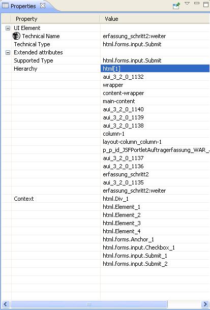

Another example:
This is the Button I want to get:
<input id="erfassung_schritt1:weiter" type="submit" onclick="var fs_link = getEl('auftrag_fs_link');if(fs_link.className != 'expanded_title'){toggleFieldSet(fs_link)};return validateClientSide();clear_erfassung_5Fschritt1();" value="Weiter" name="erfassung_schritt1:weiter">
If i try ObjectMapping with ID I have the problem, that after reloading he does'nt find the component because some Components in the hierarchy do have generated IDs. If I use type as attribute name for ObjectMapping, Jubula is not able to differentiate this Button from the "Abbrechen"-Button next to it - the same with class.
A picture of the Component after ObjectMapping you can find as an attachement:
Maybe someone has an idea how I can handle the problem?
  • Attachment: hierarchy.JPG
    (Size: 48.27KB, Downloaded 200 times)
