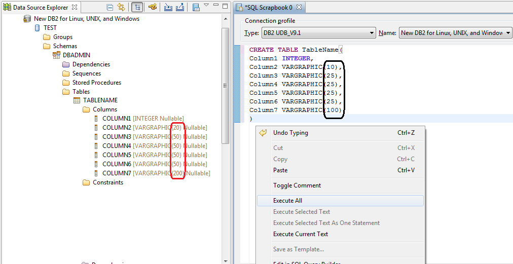

I have connected to DB2 using the DTP framework.
I am creating tables by typing the query in SQL Scrap book.(Right Click -Execute All)
CREATE TABLE TableName(
Column1 INTEGER,
Column2 VARGRAPHIC(10),
Column3 VARGRAPHIC(25),
Column4 VARGRAPHIC(25),
Column5 VARGRAPHIC(25),
Column6 VARGRAPHIC(25),
Column7 VARGRAPHIC(100)
The table is created fine, but the datatypes lengths seems to be doubled. Why is this so ?

Hi Swati,
I suspect that is because VARGRAPHIC is a "double-byte" datatype. It
uses two bytes to encode the character, rather than one. (SQL was
developed before UNICODE was created.)
