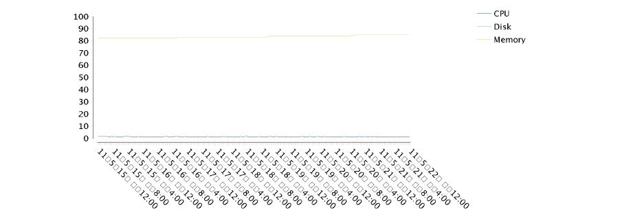

Home » Archived » BIRT » how to control the language of date format (like month)
how to control the language of date format (like month) [message #688201] Fri, 24 June 2011 03:02 Go to next message
for a chart x-axis, it is datetime.
I set the format to short, date time.
when I run the report, it show as a expected, but when run in client machine, the date shown strange symbol, it seems it cannot shown the chinese character about month.
is there any method to force the output to english like
May/12/2011 1:00 pm
instead of chinese
5月/12/2011 晚上1:00
also, which setting control the display of date to chinese or english? in browser or in windows regional settings??
for e.g. MMM/dd/yy HH:mm, what setting control the display of MMM to english or chinese?
My birt designer version is 2.2.1

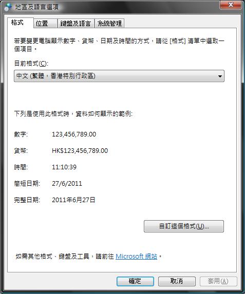

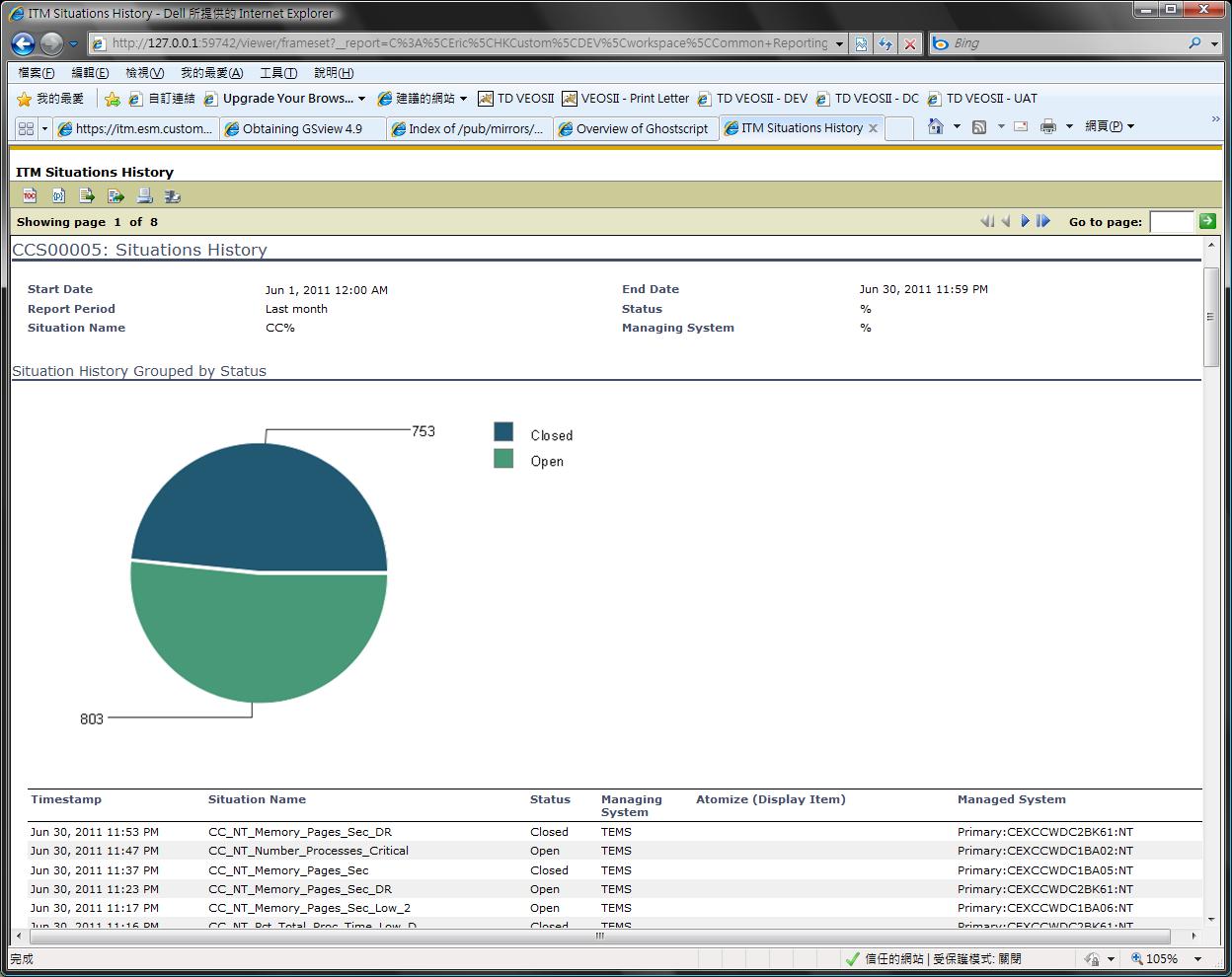

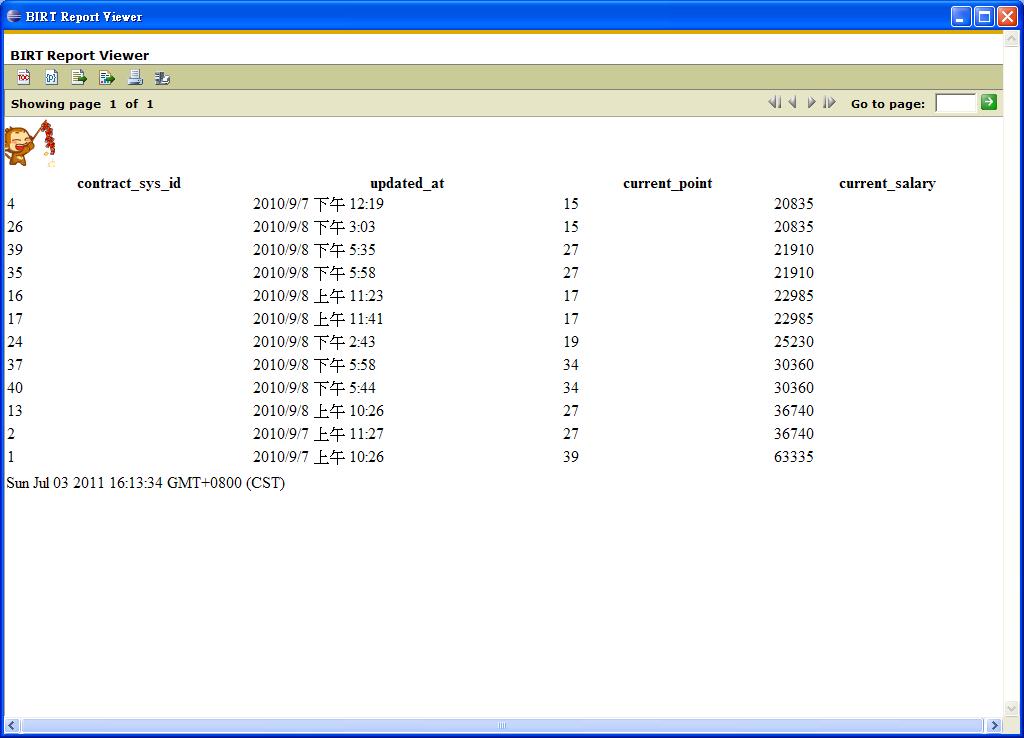

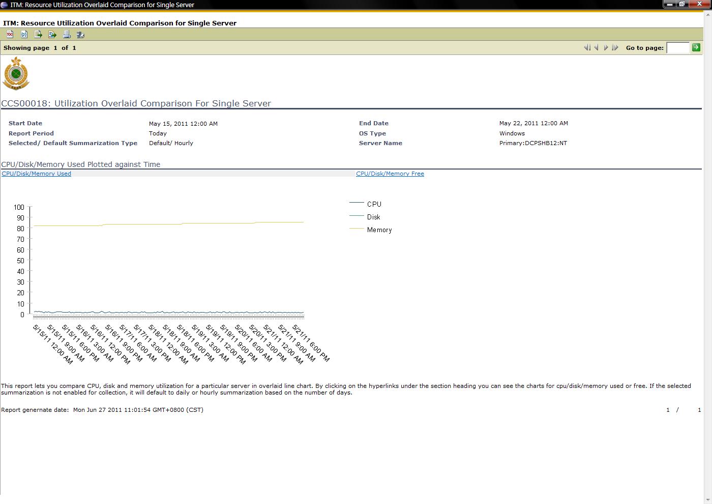

thanks for the reply, but I still want to know where to control the display format of date (chinese, english)? is it in client pc control panel?
But I find that some report show date in chinese and some show in english, I have attached my pc control panel regional setting and one of the report which show english date caption for reference.
for regional setting, my pc is set to show chinese date, but the report is show in english date caption...why would this happen?
Thanks in advance.

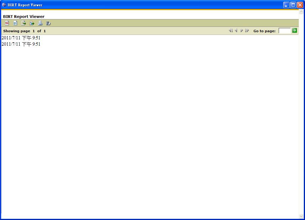

Re: how to control the language of date format (like month) [message #691886 is a reply to message #691043] Sat, 02 July 2011 13:53 Go to previous messageGo to next message
I put the following code in beforeFactory
Packages.java.lang.System.out.println ("--beforeFactory");
try{
	importPackage(Packages.java.util);
	Packages.java.lang.System.out.println("after importPackage");
	var loc = new Locale("en_US");
	_jsContext.setLocale(loc);
}catch(ex){
	Packages.java.lang.System.out.println ("error in beforeFactory, locale");
in my pc, the output of the report, date format is still in chinese!!
the output and the rptdesign is attached for reference.

Re: how to control the language of date format (like month) [message #692285 is a reply to message #692134] Mon, 04 July 2011 02:34 Go to previous messageGo to next message
it does not work.
in my office notebook, the report always show english date format, in contrast of chinese format.
the origin url is
http://127.0.0.1:59742/viewer/frameset?__report=C%3A%5CEric%5CHKCustom%5CDEV%5Cworkspace%5CCommon+Reporting%5CCCS%5CSituations%5CACCS00005%5CACCS00005_Situations_History.rptdesign&__format=html&__svg=false&__designer=true&__masterpage=true&__rtl=false&__cubememsize=10&__resourceFolder=C%3A%2FEric%2FHKCustom%2FDEV%2Fworkspace%2FCommon+Reporting%2Fresources%2F&-1561881804
no any locale parameter, I try to add &_locale=zh_TW in the url and refresh
http://127.0.0.1:59742/viewer/frameset?__report=C%3A%5CEric%5CHKCustom%5CDEV%5Cworkspace%5CCommon+Reporting%5CCCS%5CSituations%5CACCS00005%5CACCS00005_Situations_History.rptdesign&__format=html&__svg=false&__designer=true&__masterpage=true&__rtl=false&__cubememsize=10&__resourceFolder=C%3A%2FEric%2FHKCustom%2FDEV%2Fworkspace%2FCommon+Reporting%2Fresources%2F&-1561881804&_locale=zh_TW
but the date format is still in english, so it seems that _locale parameter in url has no effect on the datae format in the report...
[Updated on: Mon, 04 July 2011 02:36] by Moderator

Re: how to control the language of date format (like month) [message #695325 is a reply to message #693663] Mon, 11 July 2011 09:56 Go to previous messageGo to next message
I already spend many time on this problem but still cannot get a solution.
I just follow your suggestion, add code
//var loc = new Locale("zh_TW");
var loc = new Locale("en_us");
and add a dataelement, then view report in web viewer, the output is still in chinese date format as attached!!
my birt designer version is 2.2.1
Could you provide a successful sample for me, one for chinese date format (e.g. zh_TW ) and the other for english date format (e.g. en_US) using birt designer 2.2.1?
