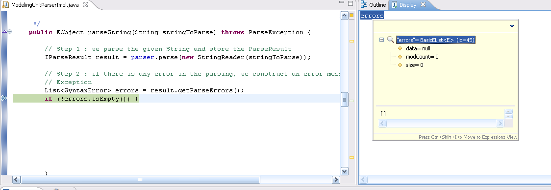

Thanks for your reply.
I always check for the parseErrors before serializing :
http://alex.lagarde.free.fr/xTextFAQ/screenXtext.png
I know it's easier to use XtextResources, but in fine I would like to create my own Resource : I want my AST to be stored in a CDO Repository, so if it is possible I would not like to use XtextRessources.

> Injector guiceInjector = MyDslStandaloneSetup.doSetupAndReturnInjector();
> parser = guiceInjector.getInstance(IAntlrParser.class);
> serializer = guiceInjector.getInstance(SerializerUtil.class);
> // Step 3 : we parse the given String
> IParseResult result = parser.parse(new StringReader(stringToParse));
> // Step 4 : we get the AST from the parse result
> EObject parsedAST = result.getRootASTElement();
> // Step 5 we serialize this AST
> SerializationOptions options = new SerializationOptions();
> options.setFormat(true);
> options.setValidateConcreteSyntax(true);
> String serializedForm= serializer.serialize(parsedAST, options);
> Can anyone tell me what I do wrong ?
> Thanks by advance !
